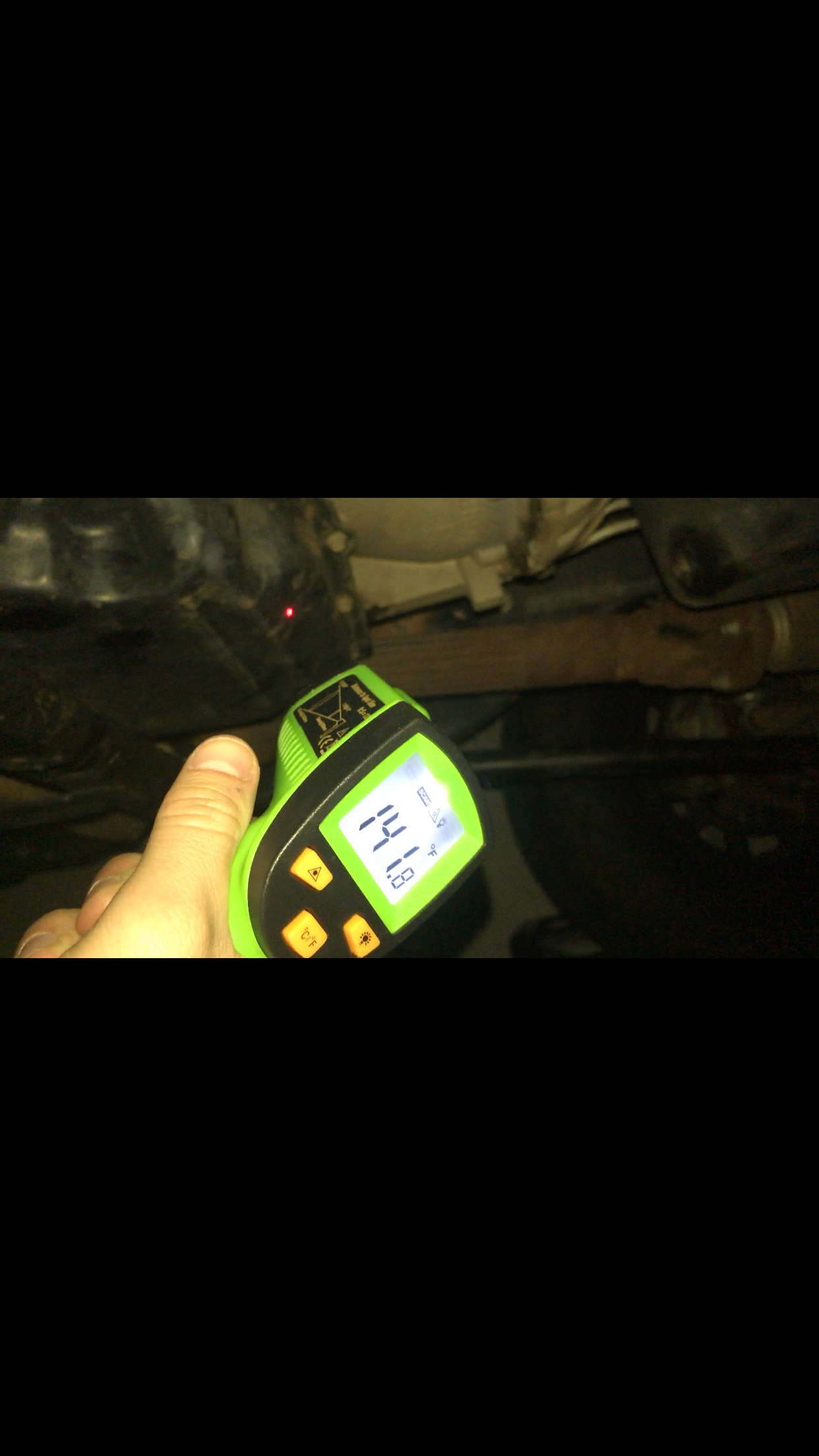

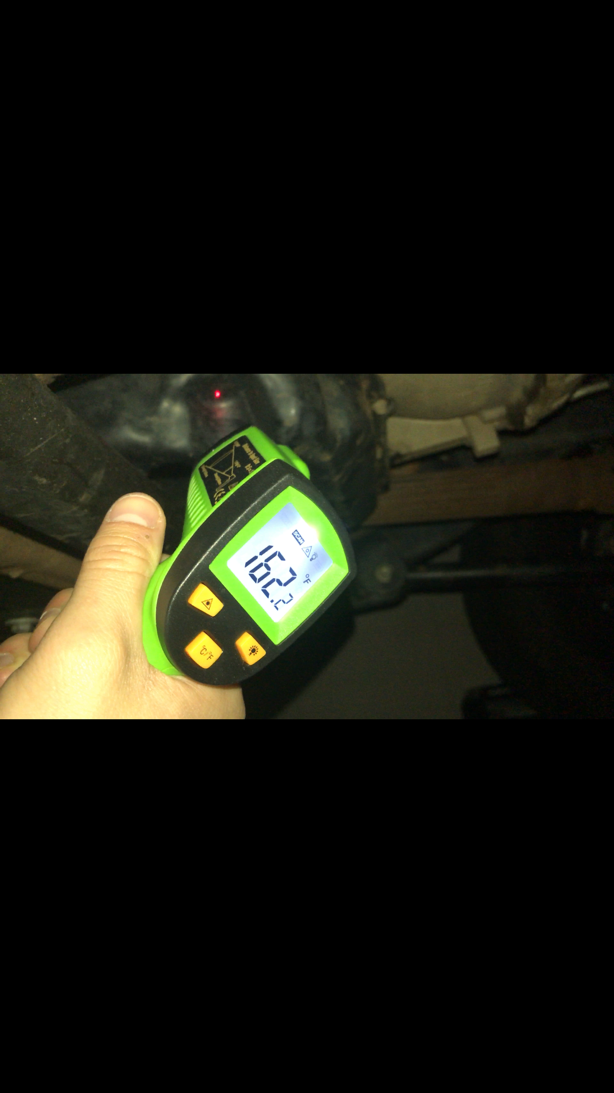

Check out these two different pictures taken at the same time. You can see where the red dot is and the temp on the gun.
Hotter temp is aimed at the indented spot and other is the front flat edge mentioned before. Outside temp around 70 degrees for most of the drive.

One reading is directly at the the indented area on the side. The other reading appears to be from an angle on the front edge. Try the front edge from straight in front of it.
You can read from all over the pan and not know which reading is closest to what the computer sees unless you can access the data. In my case, it was the front edge, from directly in front, fairly close to the pan.
If you want to know the temperature of the fluid in the sump, I suggest you get an instrument to connect to the data port, or put a probe in the pan, wired to a gauge in the cab.
