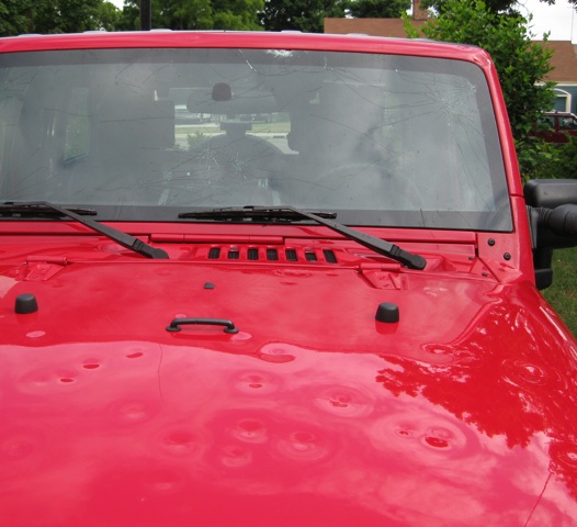

I was in the same boat......this was at my house about a month after I bought it.
The hood looked like it went through a war zone. I hit the dents from the underside with a heat gun, and then dumped a small bucket of ice over the area I just heated. It popped 99% of them out. There are still a few, but you have to really look for them.
