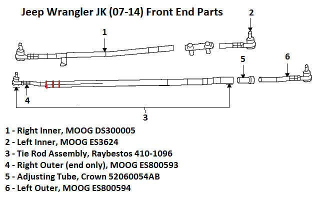

upon replacing the tie rods im stuck on getting the passenger outer off. It seems to have some crimps on it keeping it in. What must i do in order to remove it to replace with the new one? Much help is appreciated

Hmm. I'm confused. There is only one tie rod. It has two ends, one on the passenger side and one on the driver side, each connected to the steering knuckle, so there's no "passenger outer". I don't remember any crimps. Basically, you use a set of tie rod pullers to work it off (pullers, not a pickle fork). Or, if you're replacing the ends, you can beat on the stud until it comes off (don't beat on it too hard if you're not replacing the ends, and definitely not recommended on the side of the drag link connected to the Pitman arm--you could damage the steering box). Perhaps you could provide a picture?

I haven't attempted to disassemble the passenger side, I hear it is tough, but doable. A vise, long breaker bar, maybe a little heat, and possibly another person to help are what I have read on various forums. After scratching my head about what parts are what when I replaced mine (different stores call them by different names), I made up a little cheat sheet for future reference. The red lines are factory crimps that are keeping the outer TRE from easily being removed. Best bet is to do what I did and order the Raybestos assembly and keep the stock to take apart and use when that one needs replacing. Hope this helps.
Not sure why the image is so small, but click it and it will pop up a bigger version.

Oh, doh me! He's rebuilding an OEM tie rod? No, just replace the whole thing, preferably with aftermarket.

It is one piece and does not come apart.
I replaced both ends along with the drag link with Moog components.
