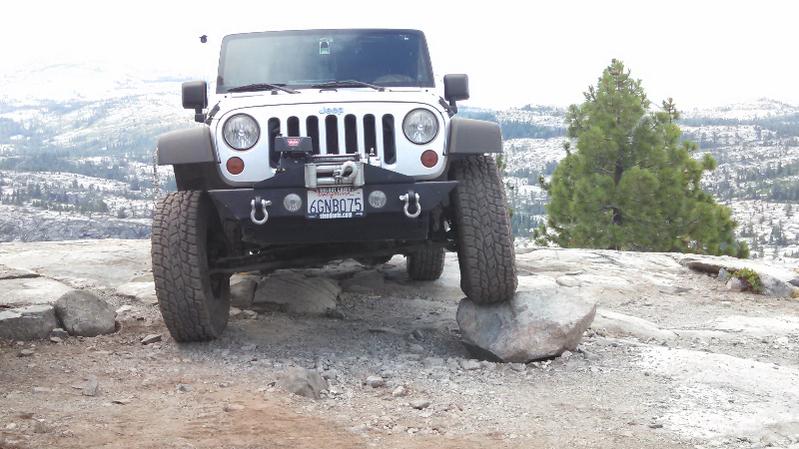

I am running the toyo AT2 extreme now 285/75/17 great tire. Did the Rubicon with them stuck like glue on the rocks only thing now is I'm thinking about going 35 same tire.
