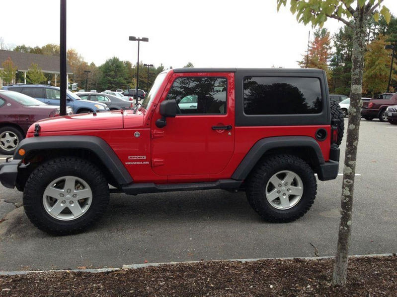

I just replaced my factory 255/75/17's with Goodyear Duratrac's 285/70/17
Had to go with small spacers but as soon as they come in I'm going with the mickey Thompson mt-88's for that all black look
I plan on a 2.3"-3.0" lift first thing in the spring...
Matthew
