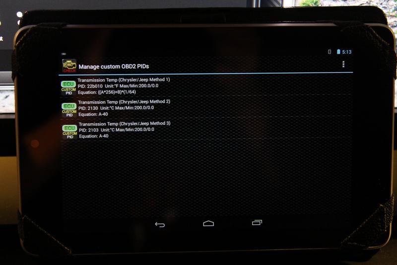

Originally Posted by crusaderJK
I had to set the PIDs myself using the instructions from the forum. There wasn't a specific Chrysler PID list in the app (only Ford, Opel/Vauxhal, Pontiac, GM and Nemesis aka Prius)
My temps are set in Celsius so that equals your coolant temps.
I did nothing to add these. My son-in-law may have done something, but I don't think so ...
ID:	501713Click image for larger version
Old Oct 1, 2013 | 02:34 AM
  #25
crusaderJK's Avatar
Posts: 620
Likes: 5
From: Zug/Switzerland
Attachment 501713Attachment 501714
That's weird....I have all of these extra PIDs except for the Chrysler/Dodge/Jeep/Mercedes
Maybe they didn't update it for the BB version.
