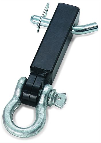

just keep and eye out for a stock hitch "take off". you can find them from free to $40 bucks.
they just get one of these hitch adapters.
this would be the safest way. Click image for larger version
this would be the safest way. Attachment 488384
x2 - That's what I use and have used to pull and be pulled. Works well.

Hitch, receiver, and shackle....already pictured above. That's what I've used and it works very well. Pulling from the center seems like a better idea than just the driver's side.
