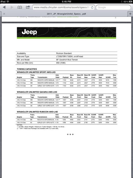

This was the specs on my 2011. Not a miss print. I'm sure you won't have an issue but just so you know.
