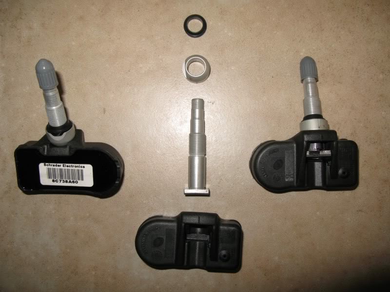

Yes, the stem just backs out of the sensor. Then you just reinstall the stem. The gasket and mounting nuts are replaced from the outside after the tire is re-mounted. The torque setting of the nut is important. The service pack kit comes with a new aluminum stem, valve, rubber gasket, nut and valve cap it's #20013, the stem 20020. All that is for my 2008 X with 17 inch tires and aluminum rims. The lists I've seen show the same parts for an 08, 09, 10. You should be fine.

Here is the photo...I hope

Cool, thanks. I ordered 20013 and 20020 from Amazon ($9 shipped total w/ Amazon Prime) on Friday. Should come Monday and Tuesday, then I'll probably get it installed on the weekend.
So that smaller nut with the flat spot on one side just sits there? Also, just the larger nut is put on from the outside, right? You said nut and rubber gasket, but the gasket looks like it's on the inside.

Yes you are correct. New stem into sensor, gasket/seal on stem inside of tire, shoulder nut on outside of rim, new valve core and new valve cap
