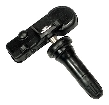

I sold my 2013 Rubi wheels and tires and had the guy take out my sensors and give them back, there are no valve stems just some black sensors with a screw in them.
Does anyone know if these will go in my new wheels? I don't see how they would connect to anything? I read somewhere above that they screw into the valve stem but don't see how that is possible.
Has anybody here installed factory 2013 TPMS in aftermarket wheels?

Do they look something like this.... You'll just need to pick up some new valve stems. Dealer, amazon, local tire shop.

Yup, exactly like that but without the valve stems.
Thanks!
