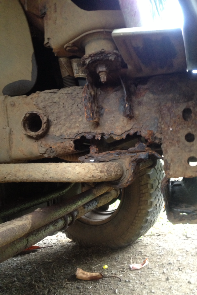

If you look at the photo you can see where the sway bar mount came off from the frame. Photo doesn't do justice. The frame has worn pretty thin. You can pull pieces off from multiple locations. Maybe if I were more diligent with rust proofing it could have been prevented. Can it be repaired? sure, but im not interested in dealing with it plus tires at 15%, brake overhaul due, other hydraulic lines oxidizing, random rat chewed wires, engine drinking oil, clutch still intact. felt as though trading was my best option and taking its equity and putting it toward a truck. I got 7k on the trade, 5k off MSRP, and a few other perks for my new daily driver baseline F150 Regular cab, 8' bed, 4x4. As basic as the new truck is its still too electronic for my liking. Im really going to miss the simplicity and dependability of manual switches, cable driven 4x4, solid front axel, etc... could be a whole other list!
I was wondering if the swaybar bracket to the frame pools water there. something to checkout/ keep an eye on. Thanks, J
