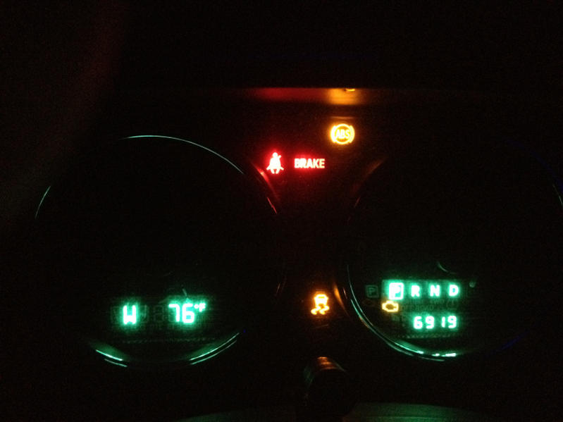

Mine did the same thing
It ended up being an ABS module that the dealership replaced. I disabled my tire pressure sensors with the AEV Procal.
