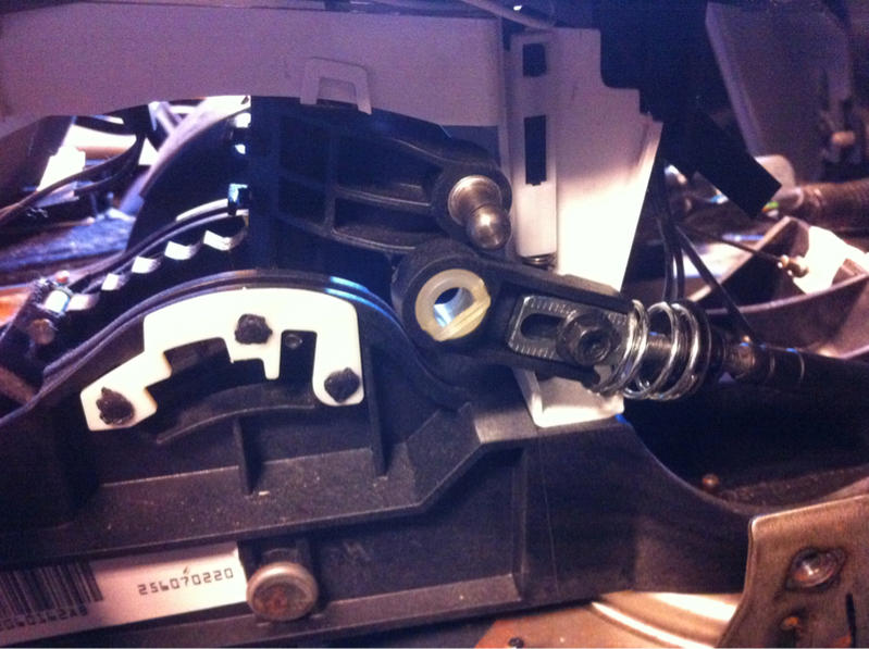

So last night the wife pulls the jeep out to run the kids around. She backs out of drive way then goes to shift in to drive but it doesn't catch. She then moves shifter around and it locks into park. It will not come out of park, luckily the transmission is some how in neutral. So we push the jeep into the garage. I then pulled out center console (ebrake is a pain to work around) and found
It slid back on with no issues but I didn't want a repeat so I opted for a improvised cotter pin.

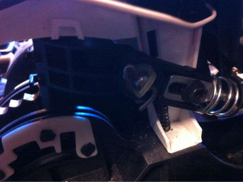

First step drill 1/16" hole

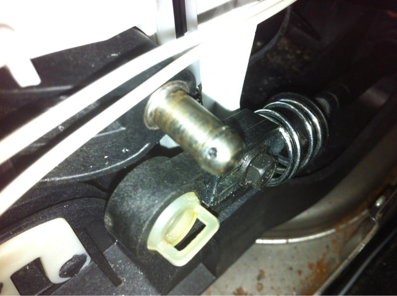

Then find small nail to turn in to a small cotter pin
Insert and done.
I then checked travel and zip tied some of the wires together to keep them out if the way.
Figured I post this up to help someone else.
