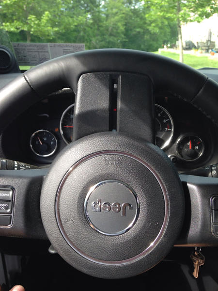

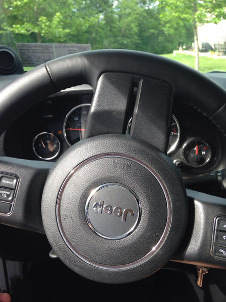

It is a stock JKU Sahara with a 10a suspension. They did fudge the ss so I had to correct that and that fixed the turning radius issue so I think. The only issue I have is the steering wheel lock to lock doesn't lineup properly. If I turn all the way to the right the steering wheel is centered. When all the way to the left it looks like it's off centered a bit.
