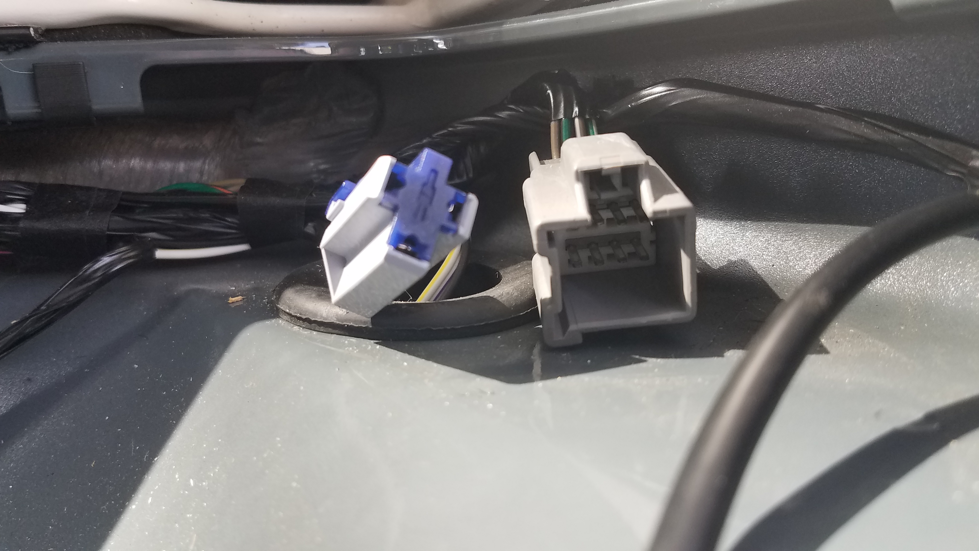

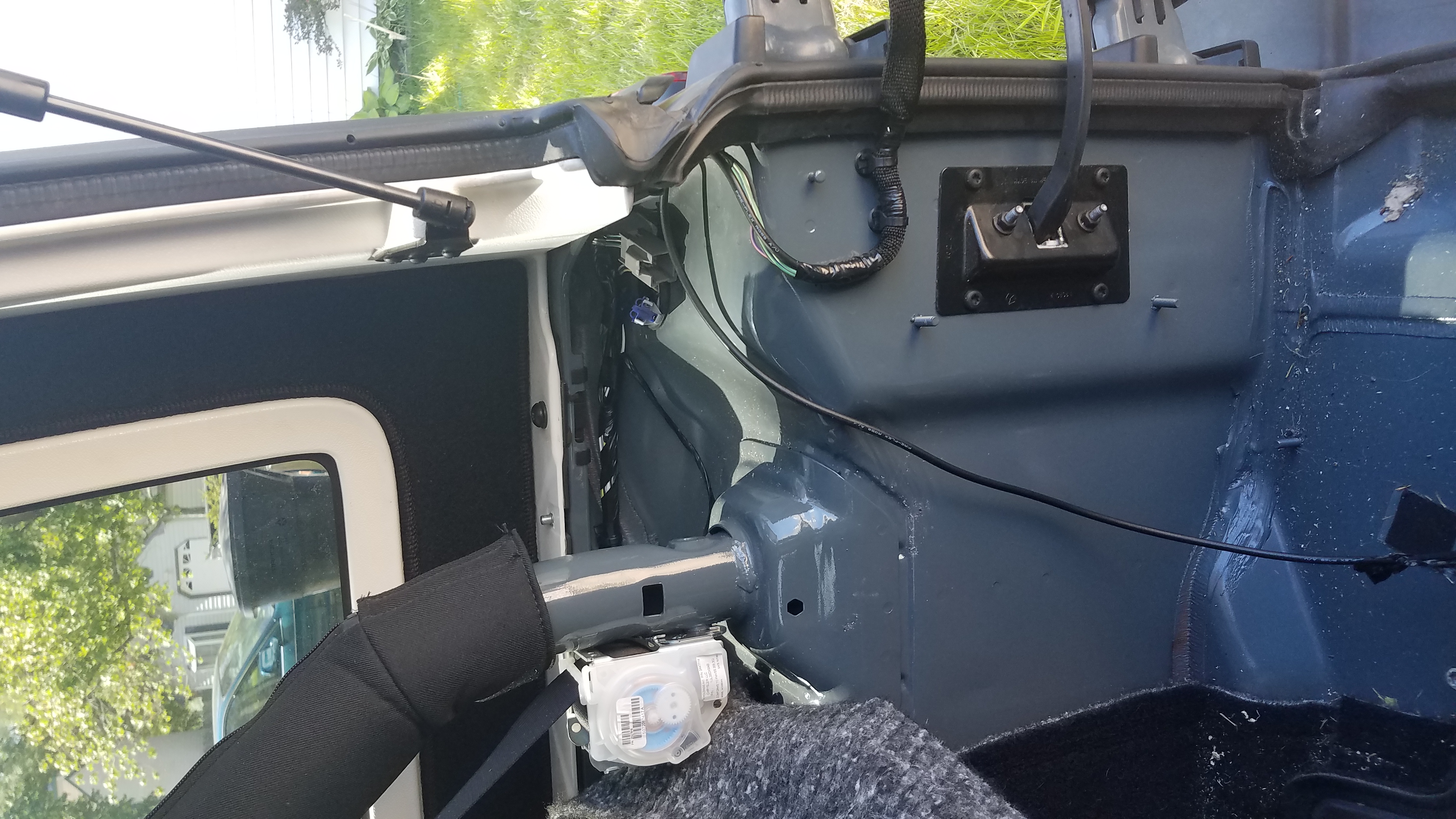

I was running a CB antenna cable earlier today, and when I removed the trim and pulled the carpet back in the cargo area on the passenger side I found two unused connectors. I was wondering if anybody out there knows what these two connectors are used for? Thanks in advance!!

Two things come to mind for me (2008 JKU) one is the motor for the rear windshield and the other is the tow kit harness. I believe at least the windshield harness is on the drivers side if memory serves me. Sorry it's been a while and we yanked out everything we aren't using when we Rhino Lined the bed.

Potentially the sub and cig lighter that is back there on some models? What year do you have, 12+, right??

The connector for the hard top is on the other side, currently hooked up. And I've got the towing package so the trailer wiring is hooked up as well, not sure where though. The sub crossed my mind, however, I didn't think it was pre-wired for it since I don't have the upgraded audio system. I just have the basic audio system... I am regretting that as it sounds like completely crap. And an additional 12v outlet would be awesome to have. I have a 2015 JKU.

That is the pre-wired plug for power to the subwoofer. There are a couple of threads and posts around here, one is mine, where people have tapped in here for power for an outlet. This is fused at the PCU and can be either battery or ignition hot, depending on placement of the fuse.
Great tip! I, like many, no longer run the subwoofer and could use a switched power in the cargo area!
Happen to have a link handy to your thread on this? Searched for threads you started but didn't see it under electric, stock, or modified.
