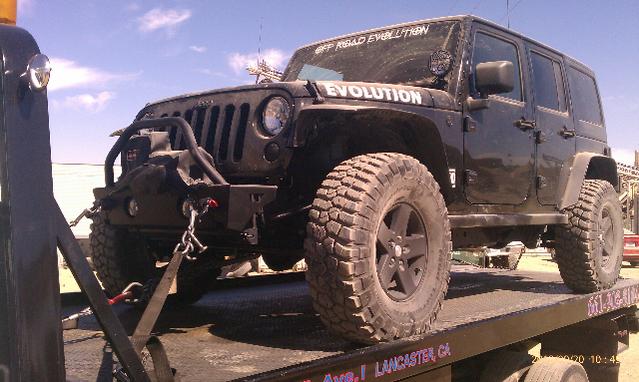

At work about to take lunch and I saw this

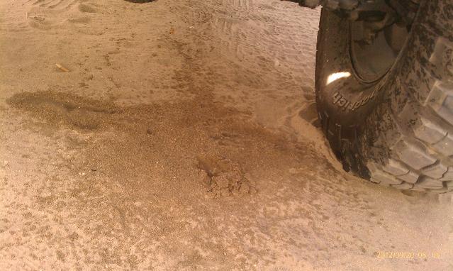

I thought it was power steering or trans fluid cuz the new jks have the problem with the lines rubbing together.
So I had it towed 50 miles to the dealer.they said it was coolant and they wanted to pressure test it over night.
