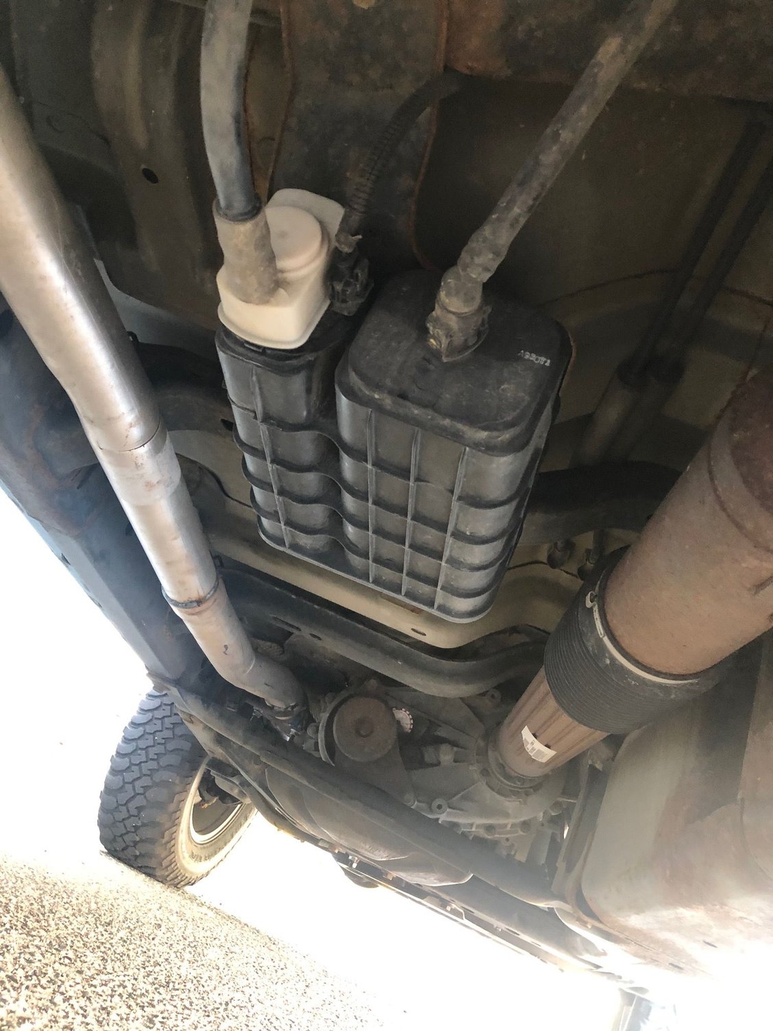

So I'm fairly knowledgeable, done a lot of work on my Rubicon myself over the years, I have almost 500K on this 2007 that I purchased new in 2006. I'm on my 2nd engine and 2nd transmission, but what is this black 2 part box - it's rattling like there's no tomorrow. any help would be appreciated. Thanks!!

It's your evap canister. Part of your emissions system.
​​​​​​Do you have any DTCs? I don't think mine rattles.

Kudos for almost 500k miles on the jeep. Jedg is correct, it's your evap canister.

Thanks - the rattle was the evap canister sensor.. going to get one now.
