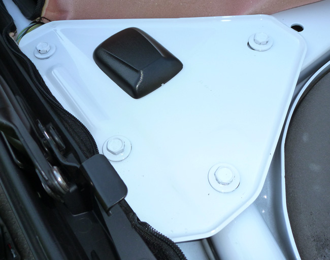

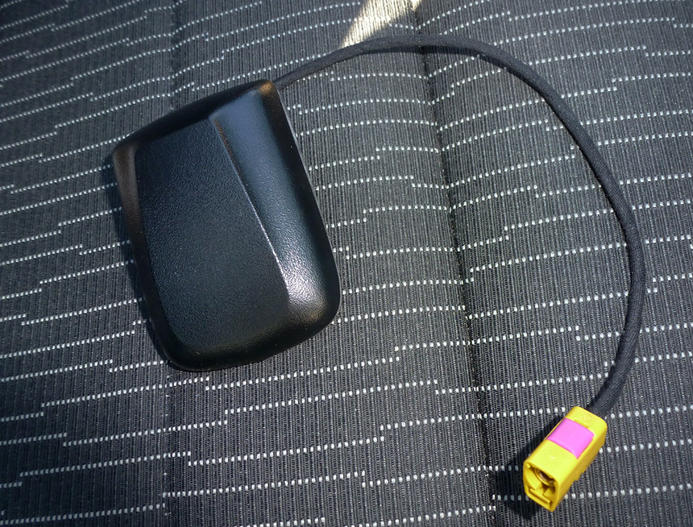

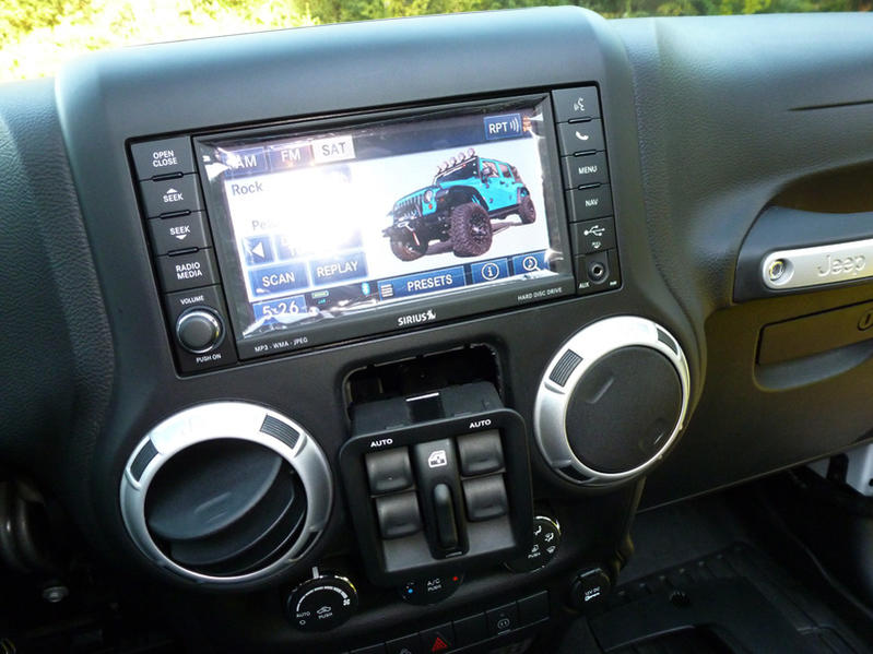

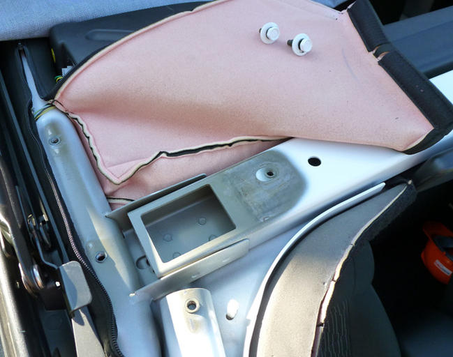

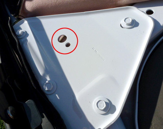

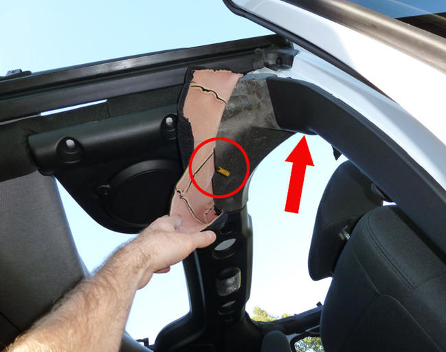

I picked up a 730n in 2012 to install in my 2011 JKU. I found it off kijiji for a good price, I was lucky. After that I had to buy the sat antenna and the mic. I bought both of these from the dealer, I want to say $150-200 approx but don't remember. I installed it all myself so really only cost was the 730n + sat antenna and mic. I hope this is what you were looking to find out. Really the only other cost was my time, which is free
It's not hard to install, you just need the patience I found to take everything apart. I will add the pics I was going to use to create a write up, which I will admit I didn't end up doing. My bad. If you have any question please ask! One word of advice i will add is DON'T leave you dash in the back of your Jeep for a week as I did waiting to get all parts to complete install. It sat sat in the sun and warped slightly and in the end didn't end up sitting flush under the deck above the window controls. Pissed me off as I am a perfectionist
Here are my install pics. I can only add 5 per post so I will have more posts to included the pics. Sorry if they are slightly out of order. Ask any questions. Just sharing my finds!

I installed the mic right behind the steering wheel in front of the dash. I've seen it installed in other spots but this location works well for me. Before putting the deck and dash back in I installed a usb cable that runs from the back of the deck right into my glove box so I can hook up a usb key or hard drive at anytime to play music from, very handy.
It was a bit of research in the beginning for me as I found nobody went this route that I could find, so I hope sharing my findings help others out. It was trial and error for me but all good in the end. Just take your time not to rip the dash out to quick so you don't break any of the clips off that hold it in. Enjoy!
