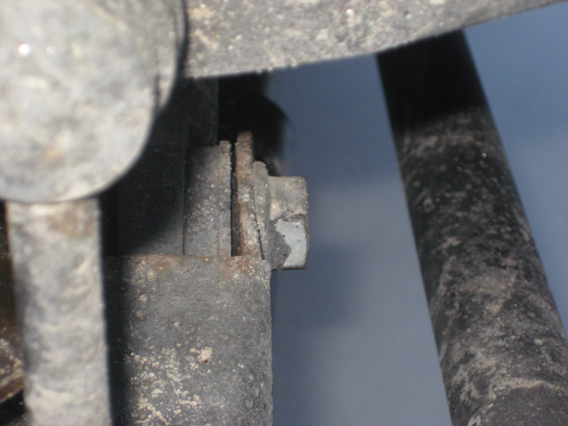

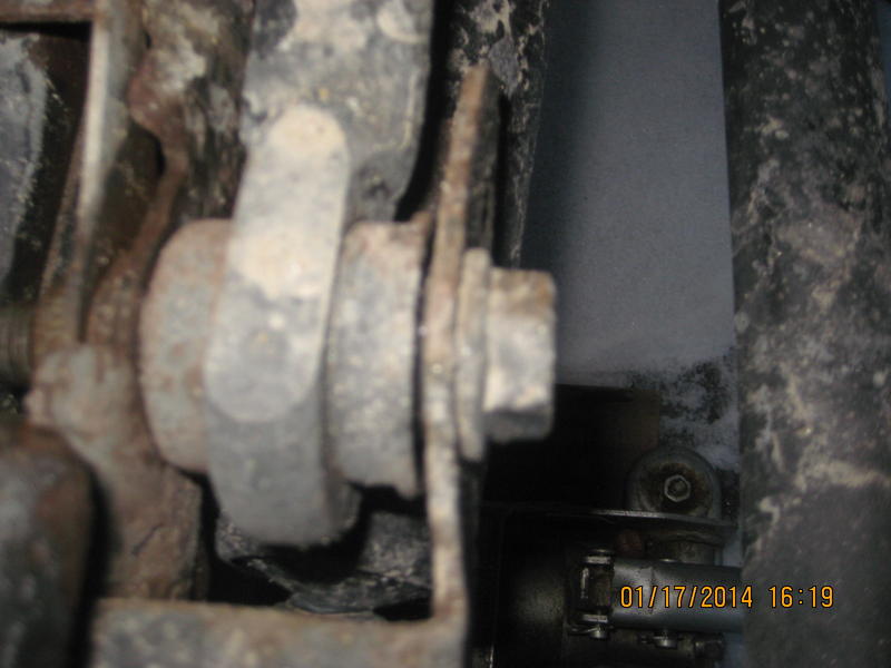

ID:	525465cant climb under it and determin this stuff in the conditions of nh right now , so the dealer has replaced the stabilizer shock which they say is not a mask it can be the sole problem 99% of the time , but it turns out I was the 1 % cuz I returned then they found my tires were outward on alighnment but within specs, but they brought them in 1 degree I guess and said . it could be tire rotation or balance of tires but I rotated when I got home and on letting it down off the lift I hear a creaking sound and a tink noise so I put it in 4 wheel drive and went to back up with wheel turned 3/4 way and I hear tink crink the I go forward and turn wheel other way and tink noise so I brought it back and they will check axle joints and track bar as I requested . pulling track bar out and show me that the bushings arnt ovaled out or worn . so I wont object to this , id like them to just replace the track bar to rule it out totally ! we will see . then im totally aware of the grade 8 bolts and will perform this soon im not sure of the locations of some of these parts are and will need to by a tork wrench and big one too id imagine for leverage lower control arms are the long rods that go from the rock rails area to the axle area im sure and same in rear ? and then two bolts in the track bar frame side and bracket side . the dealer seems to be willing to investigate it a bit on wed . and that's fair . if it dosent get resolved certainly be using the video you made its very clear how to check things . and thanks for posting such a informative video !
https://www.jk-forum.com/forums/jk-w...5/#post3375471 I will say this I don't believe the dealers will agree with the video in areas of interest ! understandable , concidering they have their own methods and Chrysler and dealership proceedures and steps are how they attack it ! I know it will be resolved so im not overly concernd , I know the old saying if you want it done right do it yourself but , I am under warranty and the dealer is helping get the bug worked out so im thankful the service manager seems very fair and proffesional yet not hard to get along with at the same time. and wants to resolve it . I just wonder what the clinking noise is myself . and a death wobble isn't anything to be to laxed about !! you need a dry place and two people to do those steps and proper tools . im not exactly equipped at this time ! Im not sure if a track bar would make a tink or clank like a creak into a tink noise
