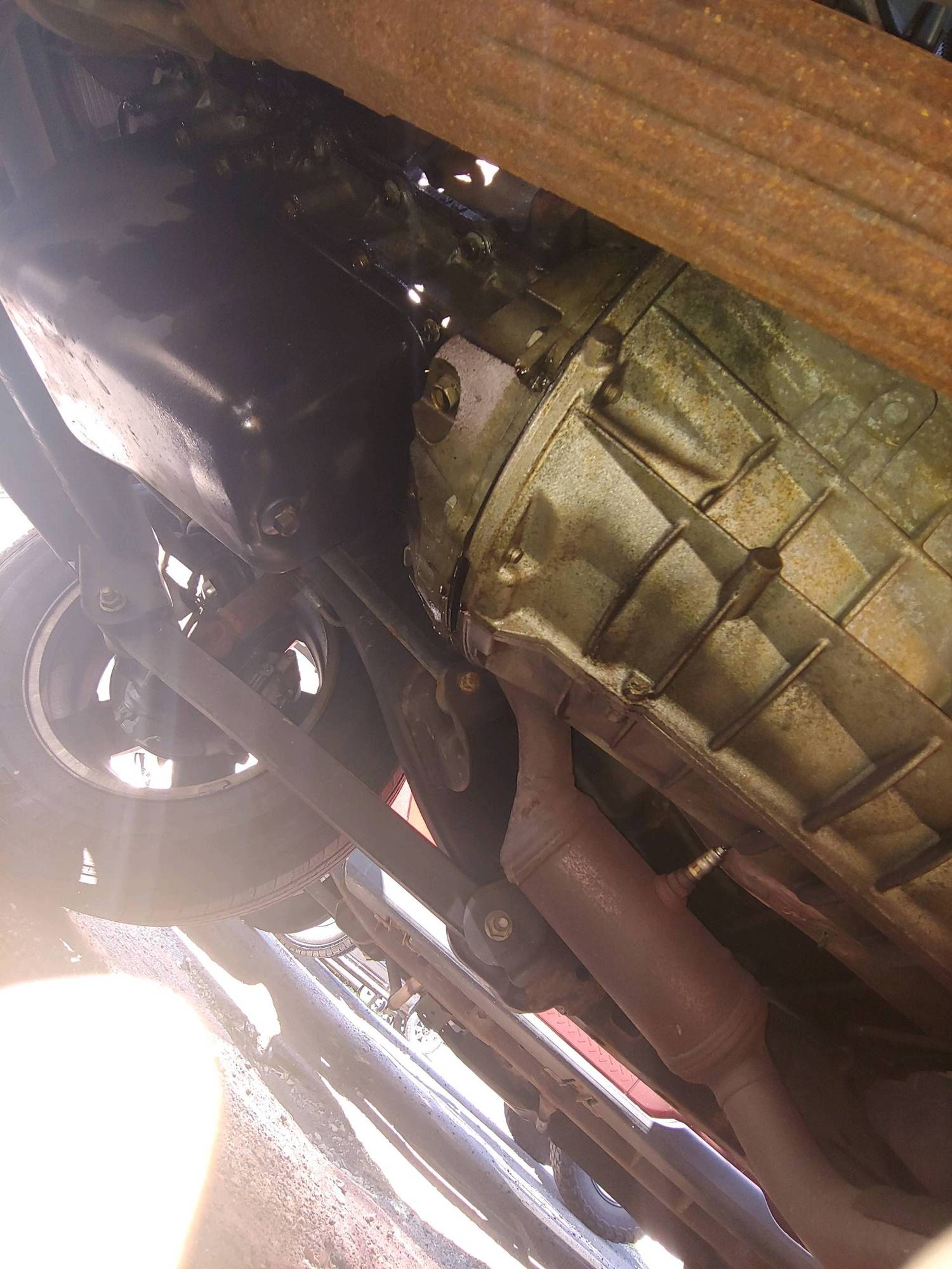

Hello,
I am new to this forum as I am considering buying a 2011 Wrangler Sahara with 176000 miles on. This is not going to be my primary vehicle and since it drives well and appear well maintained I am willing to go with the high mileage. Though I have done a good amount of research, I would appreciate an opinion or knowledge in regard to this oil leak - please see picture. I can verify that the valve covers are leaking - so they contribute to the mess, but is this also a rear main seal or an upper oil pan or all together? The leaking valve covers and upper oil pan gasket I can do myself but I am a little leery about the rear main seal. How common is the rear main seal - I know the valve cover and upper oil pan gasket are common.
Thank you
Martin

I've never dealt with the 3.8L myself, but I've been around for quite a good while and I can't say i ever recall conversations about the RMS on that engine. I mean, any high mileage vehicle that is going to be a possibility, but what you mentioned above are common and well-known issues. Personally, from where the oil is all over the lower pan, and the idea that oil leak is being blow backwards as you're driving, i think it's most likely that upper oil pan. Just my guess though. We've had many members with very high mileage on that 3.8L engine. though underpowered, pretty reliable.

I have never had a vehicle with an oil leak - does this look like a big oil leak that would deplete the oil level so fast that it is likely the owner would not have been able to keep it up? The engine has a little tick but no more than I consider normal for its design, but I am aware that oil starvation might first show its face later.
