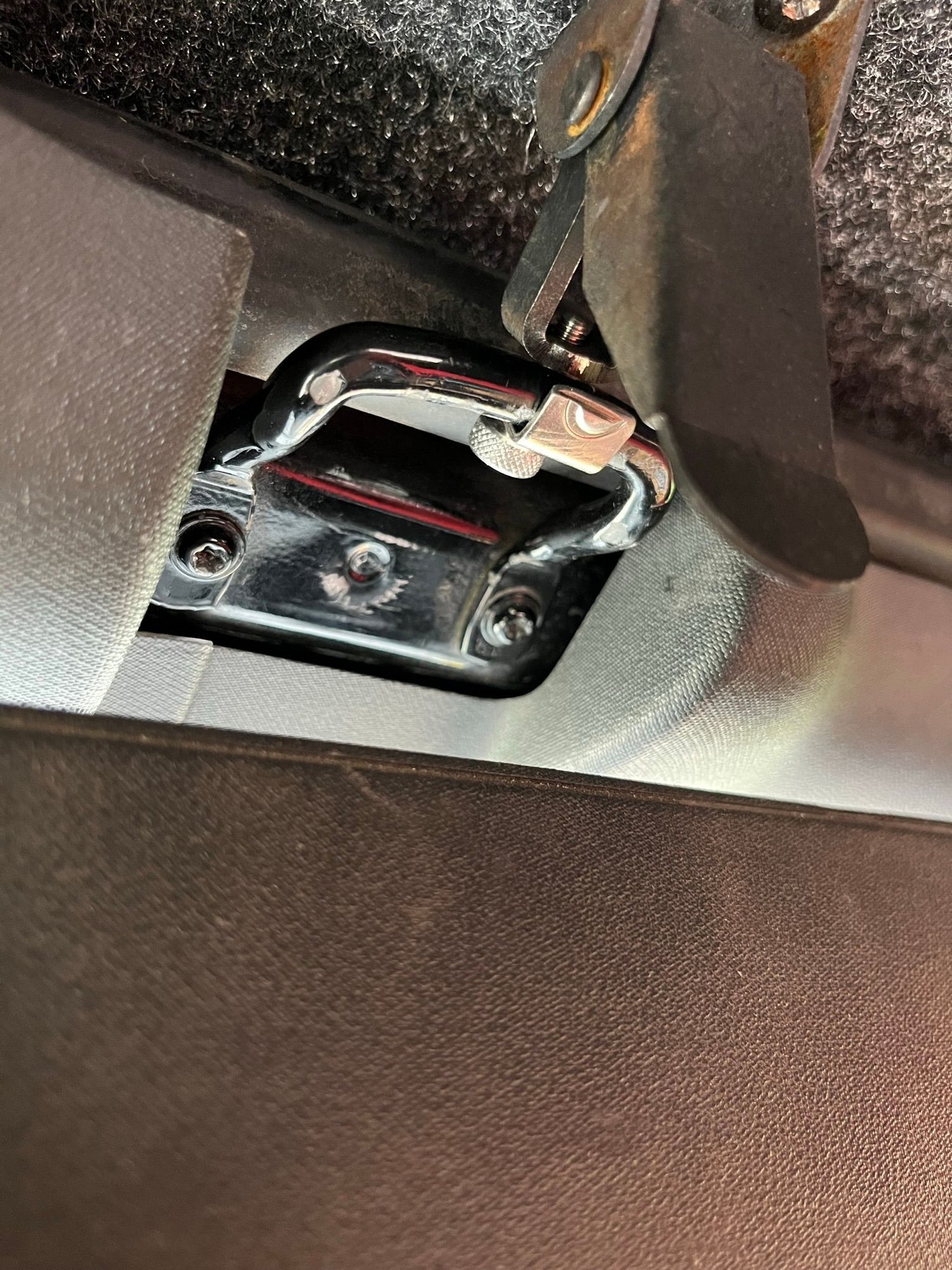

Default DV8 Footman Loop
I was looking to find a good part number for the footman loop that is required for the DV8 Hardtop. I installed the top yesterday and had to modify the front latches to work temporarily until I can get the correct footman loop. I don’t see any 2 1/8” loops, just wondering if anyone has a good part number for a set that are reasonable price. Going to call DV8 tomorrow.
