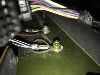

I know this is an old post, but thought I put in my 2 cents anyway.
This same thing happened to me when I had just finished wiring my new pod lights.
If you look behind the kick panel on the driver's side (left foot, if you're sitting in the driver's seat) there is a ground wire, make sure the ground is touching bare metal and the nut is tight.
I also disconnected the battery for 10 mins. Everything was back to normal after that.
Hopefully, that helps.

Thanks for the input, Scott. What year was/ is your Jeep? I saw two wires where you said they'd be and they were secured to the frame. I was wondering if the ground wire you mentioned is behind a panel. I'll go searching for it if I have to. I took a picture of what I was but don't know if I can post here.

I have a 2008 & a 2013. This particular issue was on my 2008. It sounds like you're looking at the correct wires in the correct location. (I'm going to attempt to attach a pic) If they are well secured and tight, I would also trace the ground from the fuse block and primary battery ground too.
Outside of that and any other ground; I'm at a loss.
Hope that works!!
