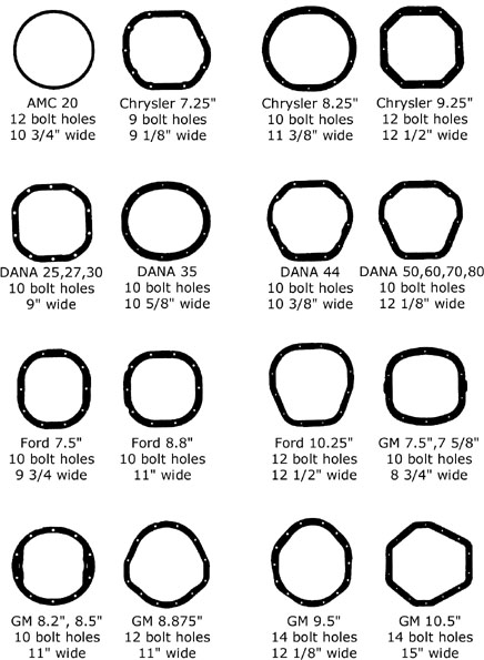

Old Dec 5, 2006 | 12:56 PM
  #24
karma0's Avatar
Joined: Dec 2006
Posts: 11
From: VT
So after asking I finally got under my wrangler, I tried to look for the marking that the website say can be used to find out the type of axle but had no luck, but did find a sticker on the axle that says part# 44 I am assuming this is the axle size but who knows. At this point I'm all stock so it doesn't matter too much, just more a curiosity that anything.

Old Dec 5, 2006 | 01:04 PM
  #25
Piginajeep's Avatar
Joined: Oct 2006
Posts: 15,133
From: O HI 4 Lo
here's an axle ID,...just match up the shape
