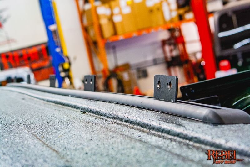

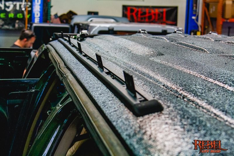

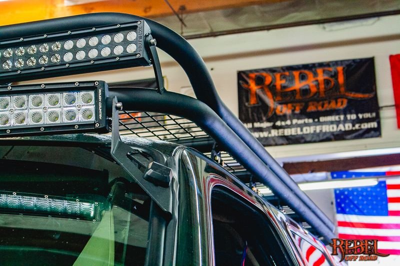

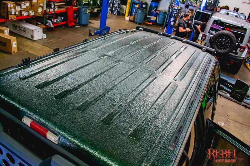

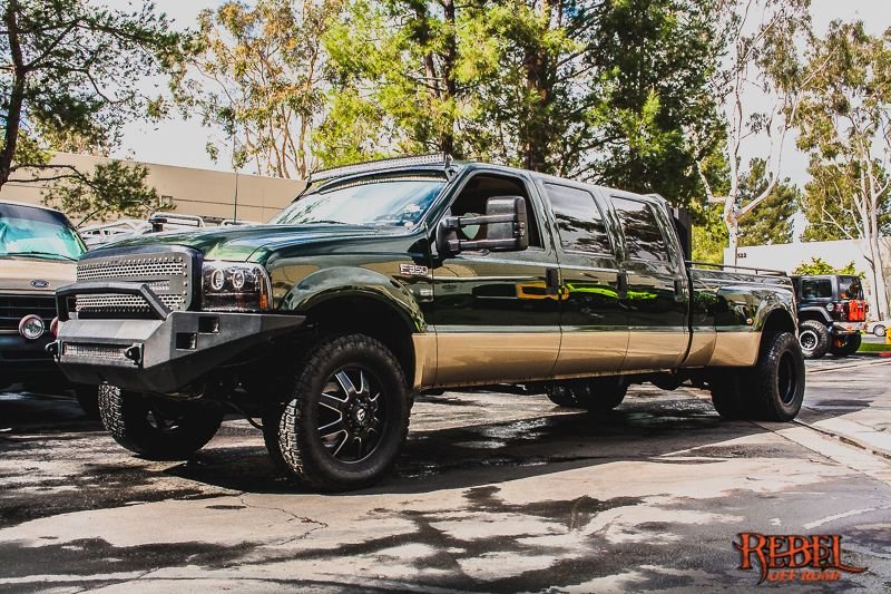

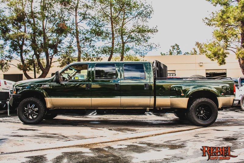

A customer brought in this beast and wanted some storage space on top, of course we were up to the challenge!
We took our Halo Series Double Bar JK Rack design and stretched it to fit the extra, extra cab. With 10 mounting points, we ensured this rack wasn't going anywhere. The slide rails were installed with silicon sealed nutscerts.
The finished product!
Before
Before: Profile
Before: Mugshot
Driver side rail installed
Passenger side rail installed
Getting ready to mount!
Checking fitment
Grade 8 hardware, because stronger is better.
