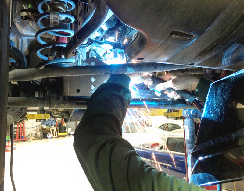

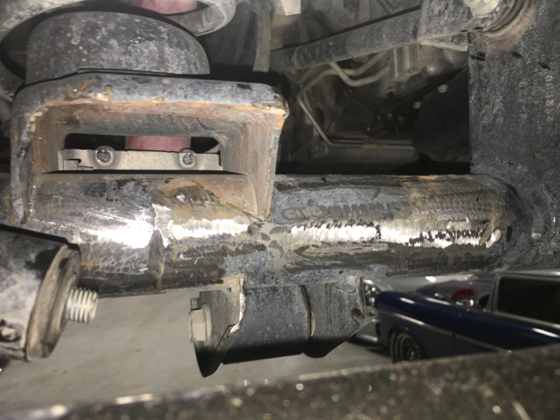

Our customer came in yesterday because he tore off his front track bar bracket, because of that we purchased the Synergy weld on track bar bracket.
The kit composed of the Heavy Duty Track Bar Bracket and the Sway Bar Relocation Bracket for the driver side.
The installation was easy and took us under a hour.
-cut of the old bracket and grind the surface smooth.
-Align the new bracket and tack in place then run your beads.
After seeing what we saw we highly recommend that you purchase a heavy duty bracket for your Jeep. You do not have to purchase the weld on one either because Synergy makes a bolt on one as well.
