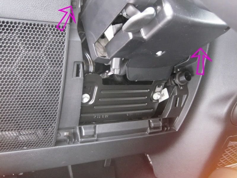

To access the front speakers, you'll need to remove the side panels, glove box, and the lower dash panels. These can all be pried off. For the glove box, you'll need to squeeze on the sides and then pull it out. On the driver's side, you'll need to unbolt and remove the instrument panel in order to get the speaker box out. The speaker boxes are fastened by two bolts on the side and one bolt on the back. Getting the speaker boxes out can be tricky because you need to rotate them downwards to get them out. Once the speaker boxes are out, you can remove the speakers by undoing the three screws on the front and unplugging the connector. Do the same thing in reverse to install your new speakers.
  • Figure 5. Pry off the side panels.
  • Figure 6. Remove glove box and lower panel (passenger's side).
  • Figure 7. Front speaker removal (passenger's side).
  • Figure 8. Unbolt the lower dash panel then pull out speaker from below (driver's side).
