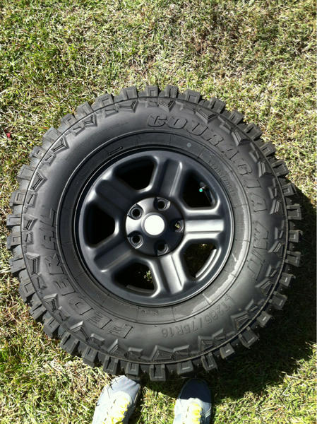

Besides special editions like the CoD Rubicon and the Altitude, for example? Powder coat or a cheap DIY alternative is to buy a few cans of Plast-Dip at Home Depot and spray them in your garage.
Just sand them down a bit to rough up the clear coat and buy some rustoleum stain black and paint them yourself. Also take some 3x5 index cards to put between the tire and the wheel so u don't have to use painters tape on the tire
