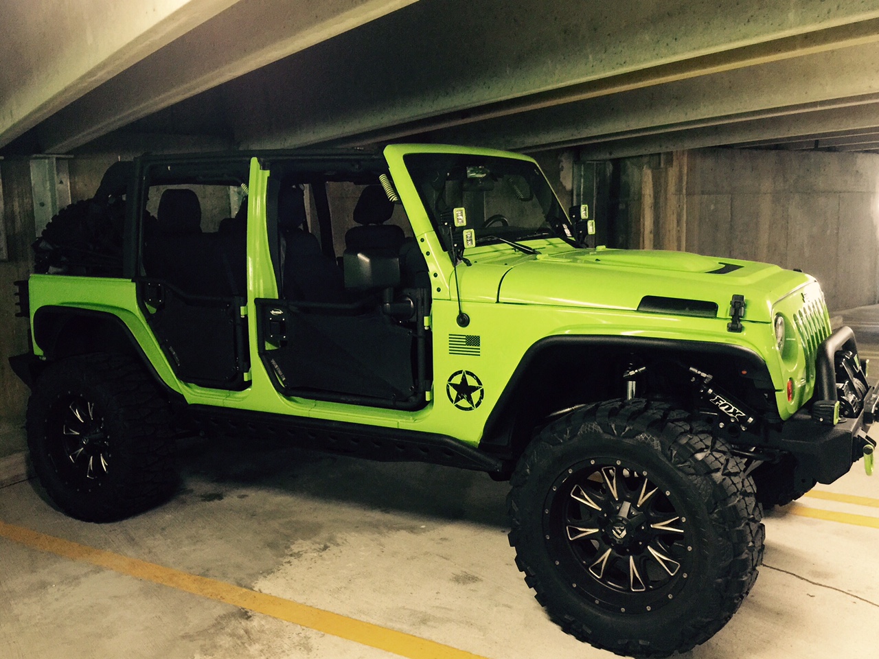

I have a fair amount of weight on my system. The current 3" is ok but I do hit the center rear axle, rear lower shock mounts, and occasionally the center skid of the jeep. I'm not looking to go big or high, I just want to get a bit more lift with still a low COG but with a better ride on street (if there is much). Simple bumps on the road at lower speeds shouldn't jar me as much (at least I don't think so). The Fox shocks helped a great deal but it still is not what I'm hoping. Off-road it is actually pretty smooth (I have the adjusters dialed in pretty soft - I could increase it and it should help on the bottoming). I was looking to get a 4" assuming it would settle down to about 3.5" which I didn't think would make the 35" look tiny. So are you saying if I go 3.5 or 4, I will need to go up to the 37"? I have 4.88 gearing now and I was not looking to redo that for the larger tires.
