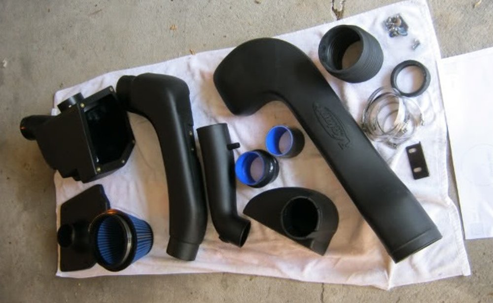

He also shared a picture of the components of the Volant snorkel kit prior to the install.
Wrangler Volant Snorkel

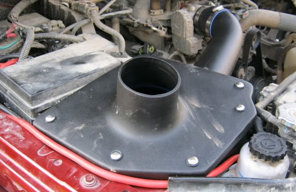

The first part of the process is to install the Volant air box that holds the air filter and the tubing that runs from the box to the Wrangler’s throttle body. This is the most straightforward part of the install, as it is little more than bolting things down to factory mounting points.
Wrangler Snorkel Under Hood

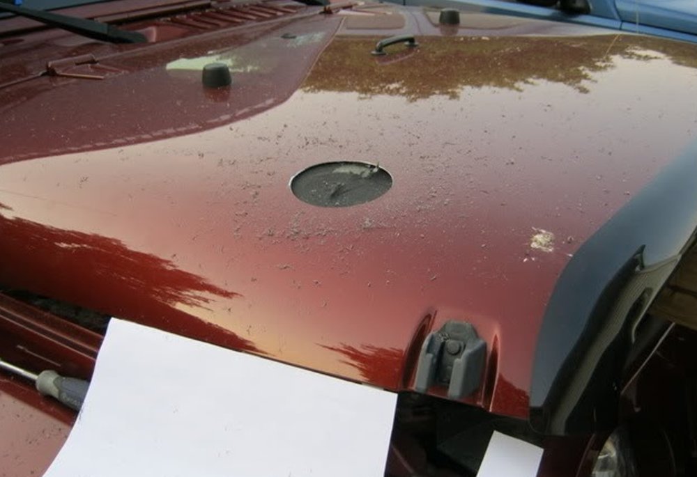

Next comes the hard part, as installing the Volant snorkel to the Wrangler requires you to drill mounting holes in the body as well as cutting a large hole in the hood where the snorkel connects to the under-hood portion of the system.

Wrangler hood hole template

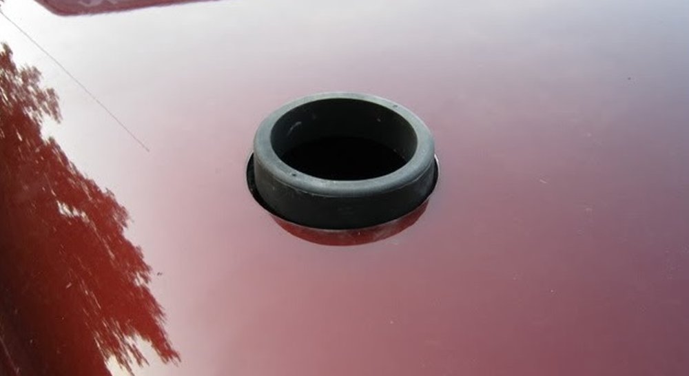

Next, he walks us through the process of cutting the hole in the hood and mounting the intermediate tubing to the hood. This portion of the DIY should prove to be especially helpful, as the OP offers some shortcuts of how to mount everything on the exterior safely and cleanly.
Wrangler Volant Snorkel Tube
