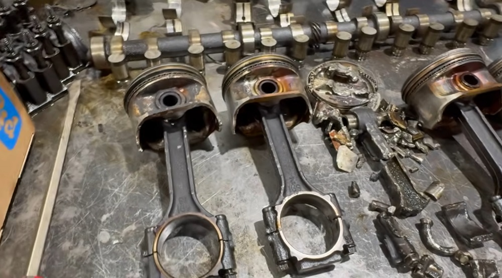

At this point the teardown begins, and we begin to see the full extent of the damage. At first it didn’t look too terrible. The intake and exhaust ports seem fairly clean. The rocker arms look OK. But the aftermarket head gasket gives us our first clue. The casket looks OK, but this engine has had some work done before it failed.
However, it all goes downhill once the oil pan is removed. Half the engine is sitting at the bottom of the oil pan. Wrist pins, pistons, bearings, rods were all chewed up and spit out into the oil pan. This is a “throw everything away” engine. The once mighty 4.0L is now just a pile of scrap.
rods and pistons
The Cause
We can’t say exactly why this 4.0-liter engine failed but there are some clues. The pistons in the engine are aftermarket pistons. This engine has been apart. Was there an issue previously? Was the owner looking for performance upgrades? Did someone screw up when putting this engine back together.
There are signs that this engine was starved for oil. Was it not serviced properly and allowed to constantly run with too little oil? We can’t say for certain. But this is not a stock 4.0L engine and it seems like someone made a mistake which caused this engine to be sent to an early grave. These engines are about as tough as they come, but if you try hard enough you can destroy even one of the most reliable engines ever made.
