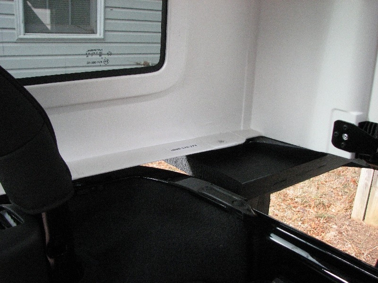

tableHalf066
Backed up the Jeep to the table:
I got in the back of the Jeep and facing the rear. I get on my knees and find the balance point of the top with my hands spread as far as possible without losing lifting strength.
Practice the lift, this is where the scratches or dropping could happen.
I lift and move the top toward the table a few inches at a time:
tableTop067
Watch the “posts” as you move to the rear. That part of the top is wider than the rear, so scratching and/or losing the balance of the top is possible.
When more of the Hardtop is on the table than on the Jeep, I “climb” into the middle of the U-shaped table and lift to the final resting spot. Climbing in is easy due to the wide areas between cross braces.
When done the top should have 6″ on all sides.
This will also make it easy to clean the interior of the top, etc…
