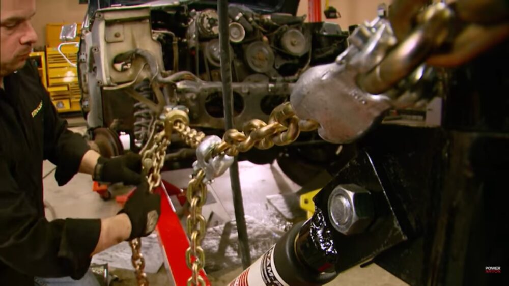

Even though this is a budget build, you still need the right tools to get the job done. Tetz shows us a frame straightener that’s specially designed to repair crash damage like this the right way.
Repairing Crash Damage at Home

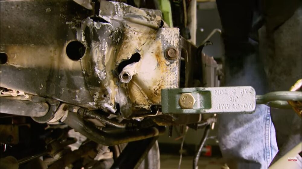

With the bumper removed, he gets a good look at the frame rail. “The good news here is that none of this stuff got up into the engine.” It looks like they’ll even be able to re-use the radiator!
Straighten Up, Fly Right
Straightening the frame rail is dangerous work, but with the right tools and safety precautions, it’s easier than you think. One thing about stamped metal is that it wants to retain its original shape, even after being damaged. That makes the job far simpler. Remember, you’re not forming metal for the first time, you’re just helping it to get back to where it wants to be.
