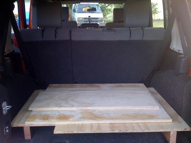

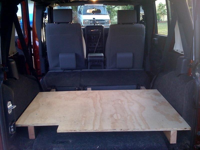

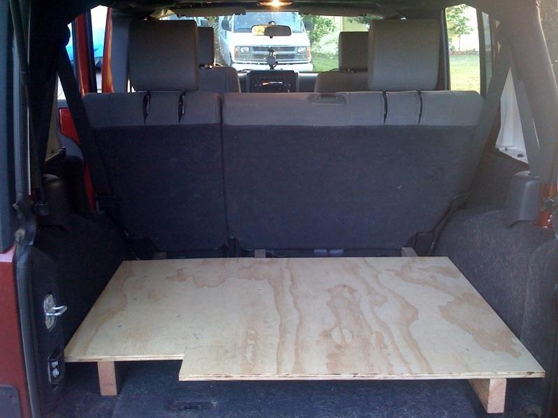

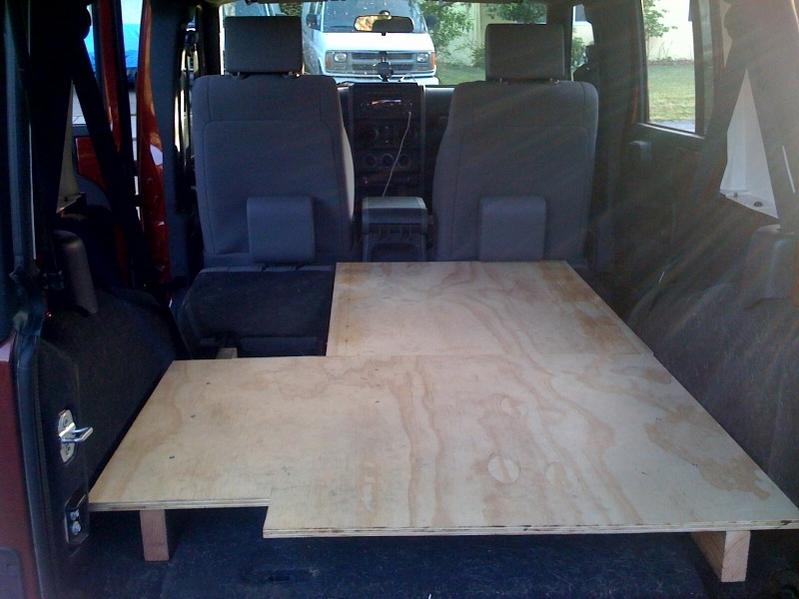

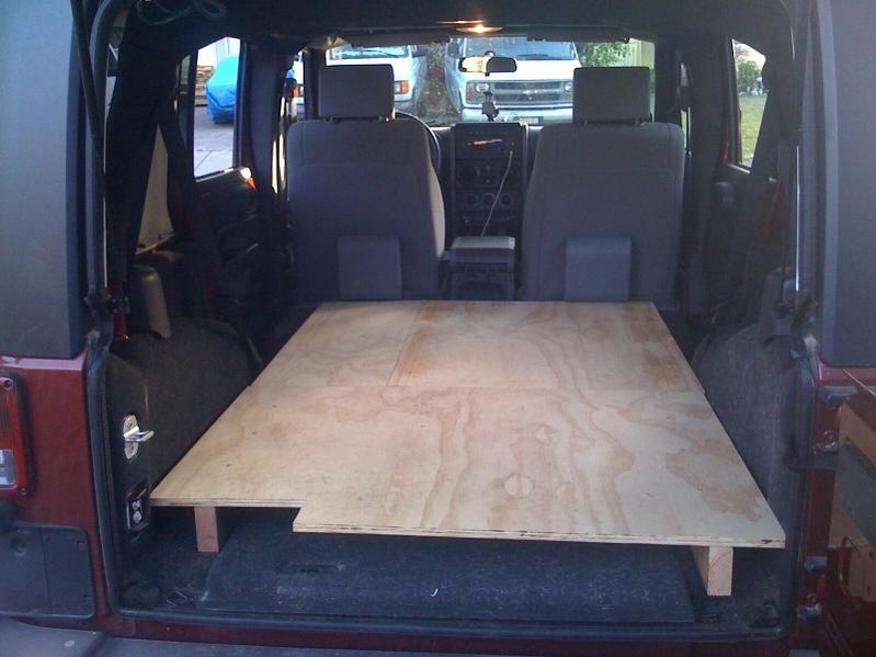

Hello All,
First post. I've been reading the threads for a while.
I recently traded in my '99 Wrangler for a JK. I was pulling a boat, and things just got to be a bit too challenging as I traveled further distances.
So my goal was to get a JK so I could sleep in the vehicle when on a fishing and/or hunting trip. I have a tent, but when the weather is really cold, or really wet, I prefer the comfort of the vehicle.
My challenge was making the back level. Having enough room to stretch out. A place to store a fishing rod or rifle (underneath). Not have the bed idea be a permanent situation while on the road. The last point would come into play when traveling with friends. We might bring two cars to the lake, but when it's time to travel to the ramp, it's nice to all go together. In this case, I can simply break down the wood pieces, and bring the seats up. The pictures will explain it all. Let me know if you have any thoughts or questions. I've been using it for several months now. Works like a charm. The JK is really nice, as there's plenty of headroom, so you don't feel like your camping in a low cave.
Cheers.
DG

Originally Posted by joepile
thats pretty slick man
i really like it, do you attach the two removable pieces with screws? or just let them lay there?
Hey Joepile,
I was going to connect the boards with dowels, but it turns out that just laying there works fine. I'm not sure if it is obvious from the photos, but the 2x4's extend forward about 3 inches toward the front of the vehicle (beyond the rear board). This allows the forward boards to rest on the same level as the rear board.
It turns out that the 2x4's on edge match perfectly with the slight rise of the rear seats when folded down, so the seats serve as a support for the forward edge of the boards.
Finally, I didn't show that when I sleep, I slide the front seats forward, which allows the rear head rests to fold down (forwar). I just stuff a few clothing items around the gaps, and it works out perfect. I put my head toward the tailgate, as I found the cold from the metal gate makes my feet cold, even with a nice bag and socks.
Boy, it would take a JK owner to visualize that mess of description.
DG
