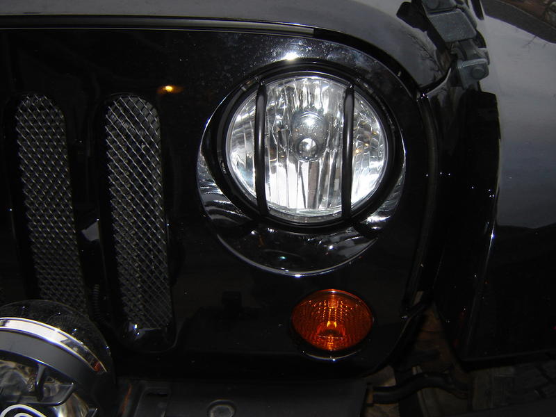

Used the gutter guard material from Home Depot with the adhesive tie pads I found at Princess Auto. Cleaned grill back well and applied them - none have come off in over a year.

The Home Depot Gutter Guard is very easy to mold. I think mine turned out very well, I also painted & clear coated the Galvanized Metal to prevent future Oxidation. I used JB Weld to keep the job simple and a solid installation.
