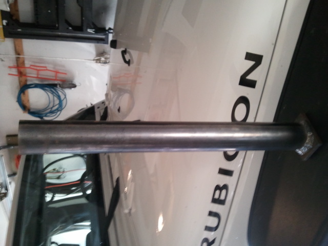

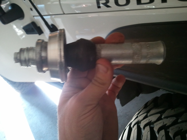

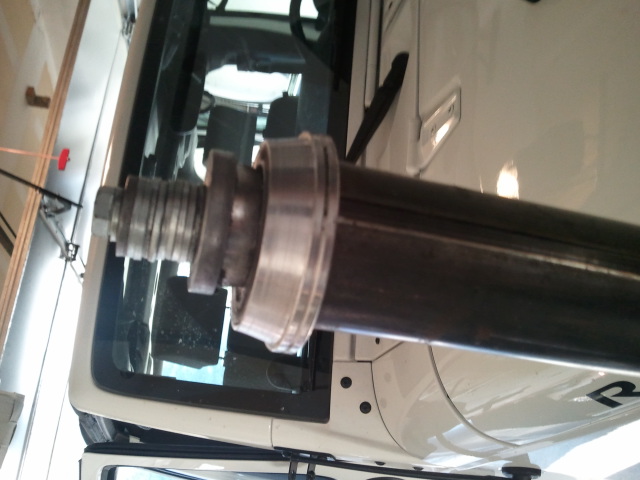

Got everything installed on the weekend. If your thing of doing these sleeves just using a bearing tool will not cut it. The handle started to mushroom on the first side. Ended up using a heavy pipe with a 1/2" striking plate welded to the end. Then slip the other end over the bearing tool and wack away with a 10 lb sledge. The last couple inches of the sleeve which is knurled is the most difficult but eventually goes in. Also I put the sleeves in the freezer overnight.

We left one wheel on so the jeep was firmly planted. No hits missed although its easily done if your not careful. Ill throw up a pic of the tool tonight though its very similar to what another member here made up. If you do a search for nitro sleeve you should find it

Here are the wacking tool pics
