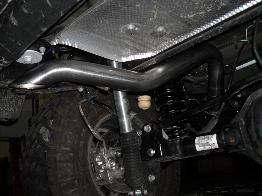

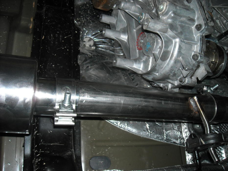

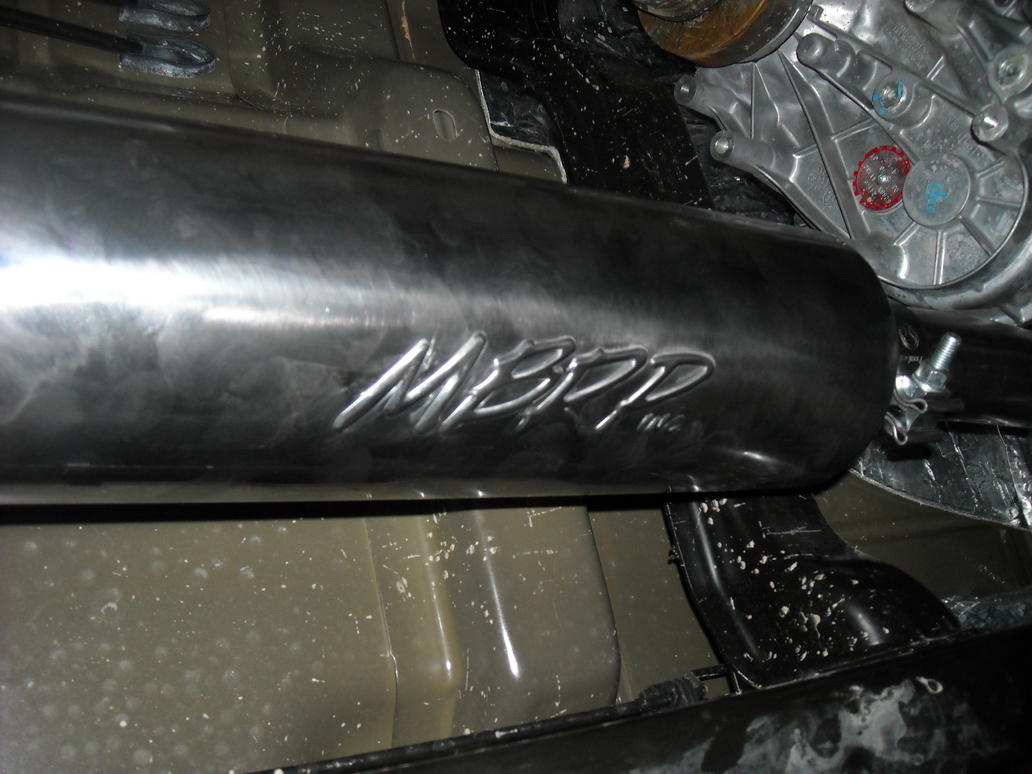

Installed my MBRP offroad exhaust today. It sounds awesome! gives it a growl without being over the top. The install was not hard. The pieces fit together nicely. The hardest part was removing the dam stock exhaust! Especially getting it off the rubber hangers. Those stupid knobs on the end wouldn't let go. If I had known how much trouble that was going to be, I would have cut the knobs off first.

nice picks, what part number is yours?

thanks. the part number is S5514409

Installing the MBRP exhaust was easy, about 20 minutes. The hard part was removing the stock exhaust from the rubber hangers. That took me about an hour and alot of cursing! If I would have known how much trouble that was going to be I would have cut off the little knobs off the exhaust hanger first. Then it would have slipped through the rubber hanger much easier.
