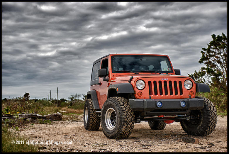

Mike,
Post a pic of your tires please. I'm thinking my next DD tire should be 12.5".
More pictures in my forum albums.. click here for more..
Name:	2011-10-03 East End Excursion (48 of 385)_HDR.jpg

what fogs are those ?? were they plug and play ?? hard to wire up to the stock set up at all ?? brand ? cost ? HID or just bulb ??
Thanks in advance

All those questions and you didn't ask 'what lift?' ......
PILOT PL203W from Advance..$30 or so.. not HID but bright as heck. The Pilot fogs have a blue lens (sadly) and the driving lights are clear.. thought I hear the fogs are now available clear as well.
The guys on the electric forum insisted the 2011 would need relays, but not mine. So, sort of plug and play. OE is some funky bulb socket that I cut off and kept with the original fog housings..just in case. I added spade connectors to the OE fog wires and the new Pilot bulb sockets and so far have had no issues. They are wired into the OE fog switch on the stalk.
The Pilots come with all the bracketry you would need to mount them, but I ditched that and simply installed them in the buckets that hold the stock fog housings. Took some fab-work, but it worked out fine.
Crap are they bright! I added them prior to the IPF H4 headlights and they made the OE headlights livable. But now, with the IPF's I no longer NEED the fogs and often don't bother with them.
They are glass lenses so I added a piece of X-Pel glass protection film.
I would love to swap them out for clear.. if anyone wants the blue, pick up a set of clear and we can make a deal.. I'll even help install them.

got any links for clear ones ? I might consider that idea... I would want to see the blue in person of course, but I dont think they would look bad on all black, I think they would look good actually
but then again, its hard to tell just in my imagination! hahah
oh I was meaning to ask you... What track bar bushing is that? Did it come with the lift?? if so what lift is that??

No links but I saw the clear housings in the parts store today.
I'm always happy to meet up and rarely need a reason. If you want to see them let me know. All my parts are from ACME. You know, the cotoye brand
