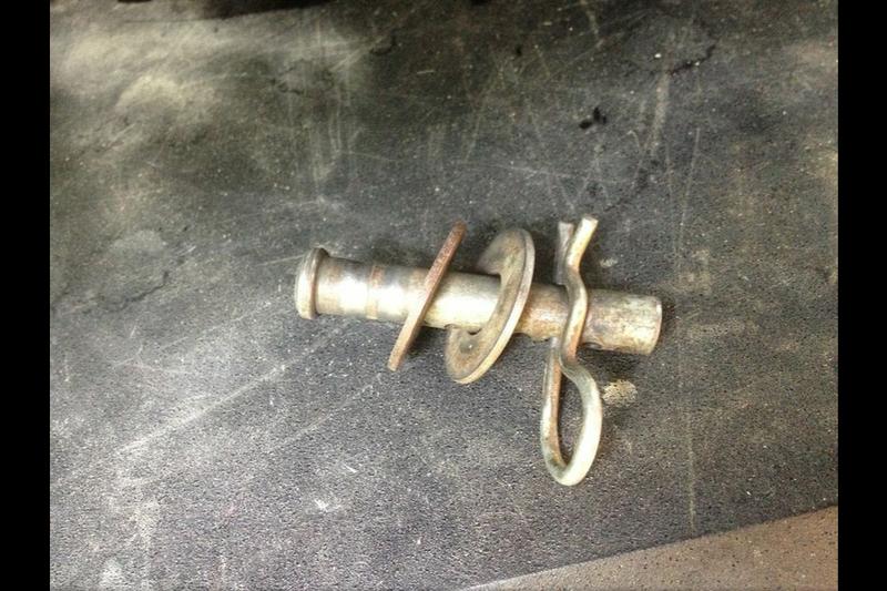

Yes both sides should be disconnected. My solution was $6 of hardware at lowes to replace the stock bolts. Takes literally 60 seconds or so to disconnect and strap the sway bars out of harms way. Click image for larger version
ID:	504325 As said before, if you only disco one side, the other end is going to be rotating around as you flex. In theory no, I don't think it would limit your flex by keeping one connected, but our tires cost hundreds of dollars. I wouldn't take a chance of poking a sidewall from something dumb like that. And testing flex on a rock or hill once and saying "nope it won't rub" isn't gonna cut it either as a test.
