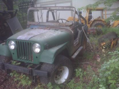

Rubi up 07's Avatar
Posts: 158
From: Georgia
Here is a quick pic. Haven't got it out from behind his shop yet so no interior pics but will get some

Old Apr 21, 2011 | 07:07 PM
Rubi up 07's Avatar
Posts: 158
From: Georgia
Also not sure if this helps but it is a 4 cyl
3 speed
Old Apr 21, 2011 | 08:10 PM
chuck_unleaded's Avatar
Posts: 1,090
From: Tucson, AZ
Shes a butte! I love it!
