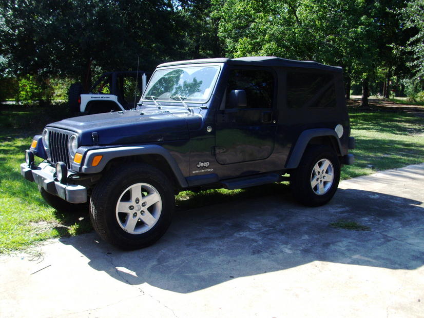

On my wifes 2006 unlimited I ordered spidertrax conversion spacers and put my old jk 17in rims and tires on it. She likes it.
Sometimes in the For Sale section, you can pick up a full set of these for pretty cheap, with the spidertrax spacers they stick out about an inch past the flares.
