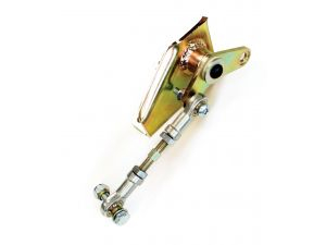

Last weekend I was on a run between Reno and Virginia City and the transfer case kept popping out of 4wd low? 1" body lift. Do I need the teraflex transfer case linkage bracket? This bracket takes the linkage off the body, keeping it from being tweaked from the body lift?

Putting in the Terra-flex shifter bracket to take the linkage off the body side. The 1" lift tweaks the angle of the shifter linkage. Terra-flex shifter mounts just to the transfer case. Going o Hollister next weekend to test it out...

Went to Hollister OHV park and never popped out of gear once. Thanks Teraflex
