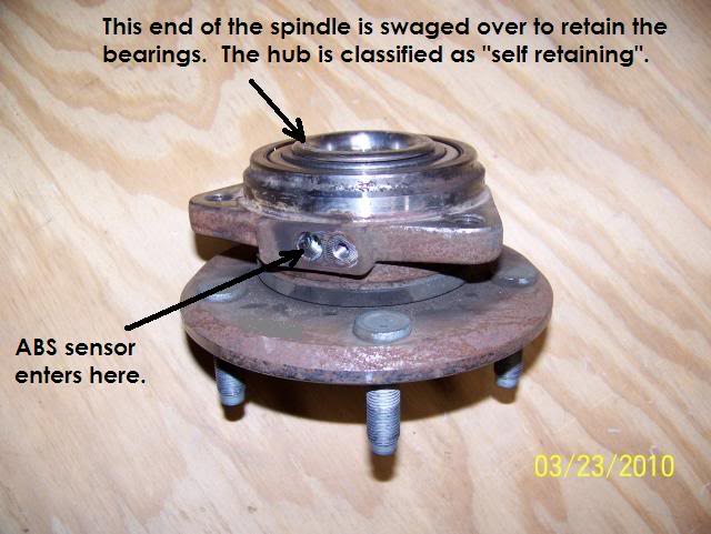

This picture shows why the stub shaft is not needed on the JK hub:
Also, if you are going to install the rubber plug, you better clean out the axle tube. The tubes may be full of rust, pebbles, sand, etc.
