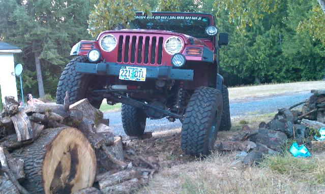

Gotta go to a 6 inch to clear 35's, also need a wheel with a decent back spacing to step the tire out far enuff so it won't rub the control arm.
Got mine kicked out pretty far and lock to lock it still rubs, 35's on a 10inch wide wheel and like a 3 1/2 inch back spacing.. it still rubs a little.
.. even twisted up u can see how far mine stick out. Sorry don't have any close up pictures, but even with the 3inch extended bush wackers almost half the tire sticks past them
