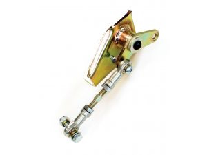

Take a look at the terraflex transfer case shiter bracket.
Old Apr 7, 2012 | 03:43 PM
Sahara707's Avatar
Posts: 42
From: Petaluma, CA
Here's a pic
