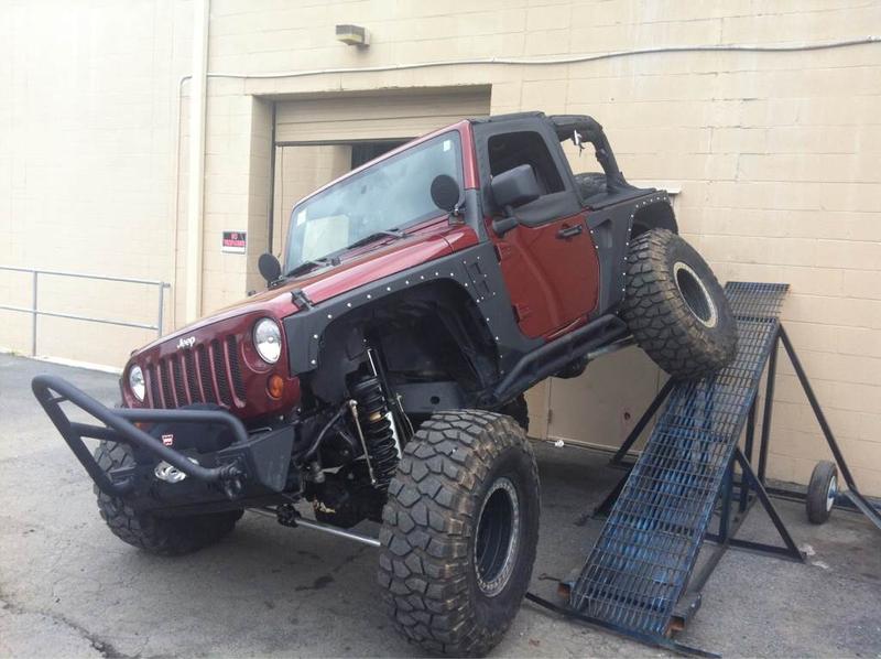

I have a 05 Rubi that I installed the Rock Krawler 5" long arm (3 linked front and triangulated rear) and it is a well thought out and put together lift kit. I couldn't be happier with the kit.
Here is a pic with tube fenders and 35" tires on the RTI ramp
Attachment 543739
Thanks! The picture says it all

The photo really shows great body stability during the flex.
I noticed that the sway bar links are disconnected in the photo. Was there a reason for that?

To gain more flex and stability off road you will want to disconnect the front sway bars. Most kits come with disconnect kits with their lifts.

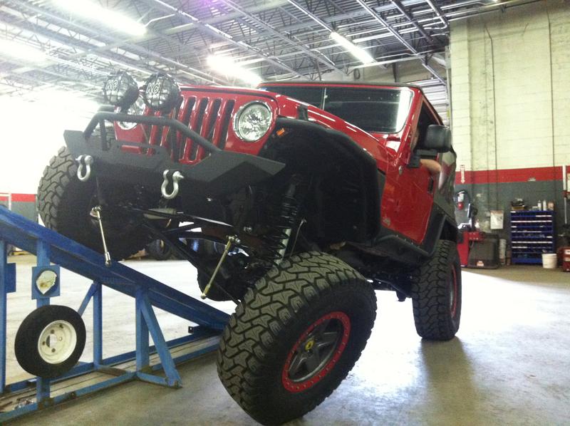

I have a build thread now for comp cutting and stretching my 2 door JK on this forum. Here is a pic of it before the cutting, it has a 5" long arm ( radius in the front and 3 linked rear) running 39" Krawlers, 1.25" body lift.......ect

The one thing I did like about the TJ long arm is that the lower control arms are bent for more clearance under the belly, and the belly pan is 3 piece for easy service or removal of trans, or T case
