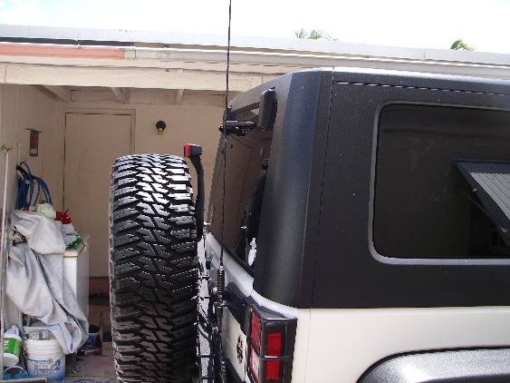

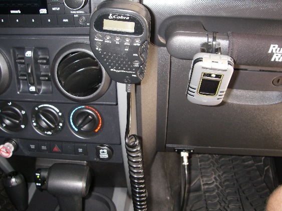

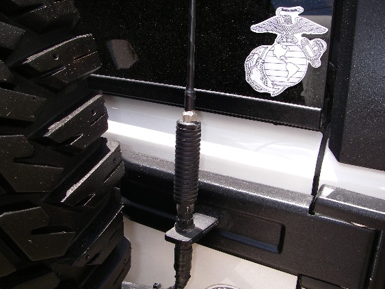

I have been using the Cobra 75 WX ST and Liberty 4' Antenna with Custom Mount for about 4 years and not one problem. I like how sleek and clean it is compared to a boxy CB.
I did add a small speaker up by the sunviser so I can here better with the doors and top off.
