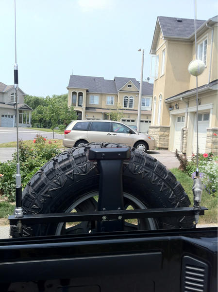

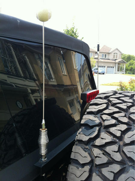

Here's what I have. Can't fit the whole whip in the picture but the one with the tennis ball is the 102". Like you mentioned, you'll find various posts why my mounting location is bad, but I like it. The only thing is it slightly interferes with my rear wiper on the hardtop. So I need to do some rearranging.

Thanks for the info and pics. I also have a ball mount but I'm leaning towards not using it and doing a solid mount instead.
<img src="https://www.jk-forum.com/forums/attachment.php?attachmentid=340632"/>
<img src="https://www.jk-forum.com/forums/attachment.php?attachmentid=340633"/>
Nice setup!
A couple questions:
1) mechanical: With the whip being so flexible do you feel any improvement using the spring?
2) electrical: do you get better performance with the 102in whip than with a 4ft fiberglass? Assuming you are using it for a CB. Or are you using it with a tuner for HF HAM?

Originally Posted by Sahara_Maverick
Nice setup!
A couple questions:
Thanks!
Thanks!
For #1) The flex is really nice to have with an antenna this big, so the spring comes in handy. Wind loading is a factor so it does bend down quite a bit on the highway. And I worry about cars behind me when I take off too fast at the lights!! Yes, you could probably be better off without the spring, but for me I need it to add just a bit of length to the antenna for a good SWR. That leads into answering question #2.
For #2) There is no comparison from an 8ft antenna to a 4ft antenna. Like they say, big is better and in the case of antennas the same holds true. I don't know the physical characteristics of the 4ft antenna you are referring to but it could be a 1/8 wave or have some coils or wiring windings to make it appear as a 1/4 wave antenna. Either way, it doesn't have the same physical length as a quarter wave antenna like the 102". Electrically it works with a radio but it "doesn't get out" (or receive), like they say.
Having said that, there are many good reasons for having a shorter antenna too, if you only need to talk on the trail and not "shoot skip" (you're not supposed to anyway) and be able to fit through drive-thrus.
If you want to read up on the 102", here is a good article.
http://signalengineering.com/ultimat..._antennas.html
And I forgot to mention, it just looks cool hanging there off the back of the Jeep.

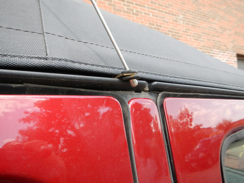

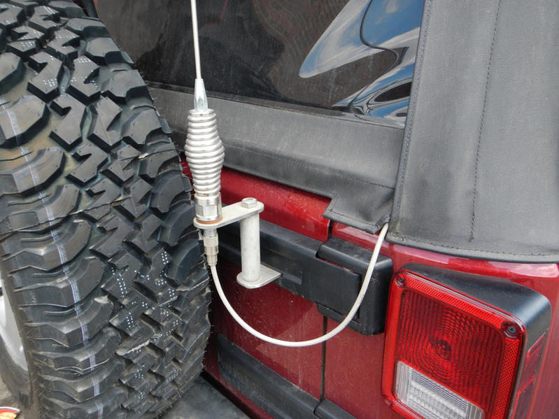

Hope it works and you can see my installation.
I used a piece of stainles angle plate and attach inside the hinge using existing bolt.
Extended post is not necessery, but it was used on previos antena that had top coil and I wanted the coil above roof line.
If you can find wider angle so the antena mount leg is further away from the door. Thats why I left the riser.
Also you can run the coax trough the gate, but do not try to feed it trough door wiring harnes, leave it on the outside.
I did that on my 08 and in the winter the coax got mangled inside the harness.
Cheers.
