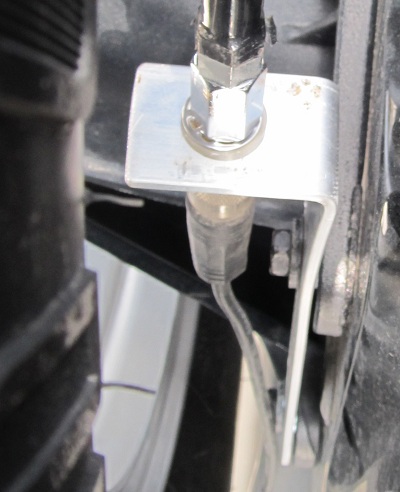

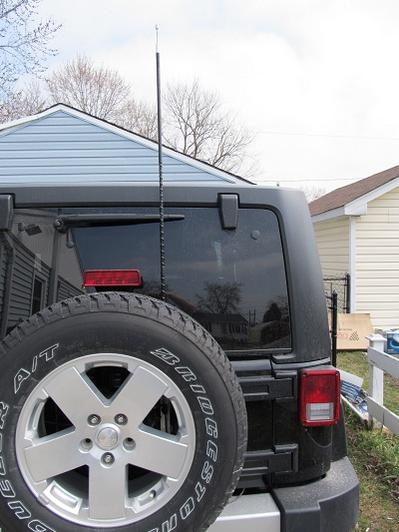

Ask and you shall receive!
I think if I remove one of the shim washers at the top it will cut down on the flex, but I drove it the way it is and it didn't bang on the top at all.
I added another "L" to cut down on the flexing, but like I said above, I think if I remove a washer I won't need it.
Materials used:
1- 3' length of 1/8" x 1-1/4" flat aluminum bar stock (you really onlyu need 9-10", so you have room to experiment) - about $7
8 - I used a mix of 1/4" and 5/16" because I wasn't sure what size would fit over the stock bolts. - under $1
1- 3/8" SO-239 stud that I had laying around - Around $5 on shipped on ebay, probably $10 at a truck stop
If I remake another one I'll probably make it shorter so the 90* is just above the top bolt like the cooltech, as it sits with a 4' antenna it's 91", I need to come down about 13" to clear my garage door lol
