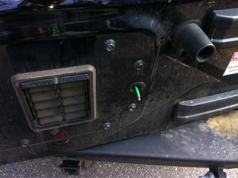

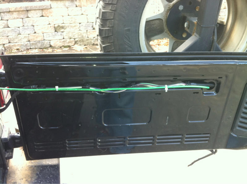

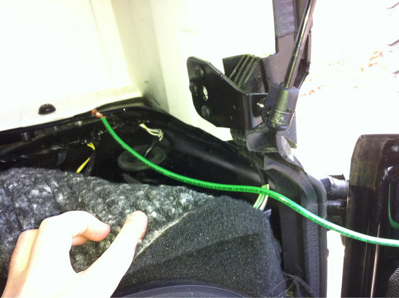

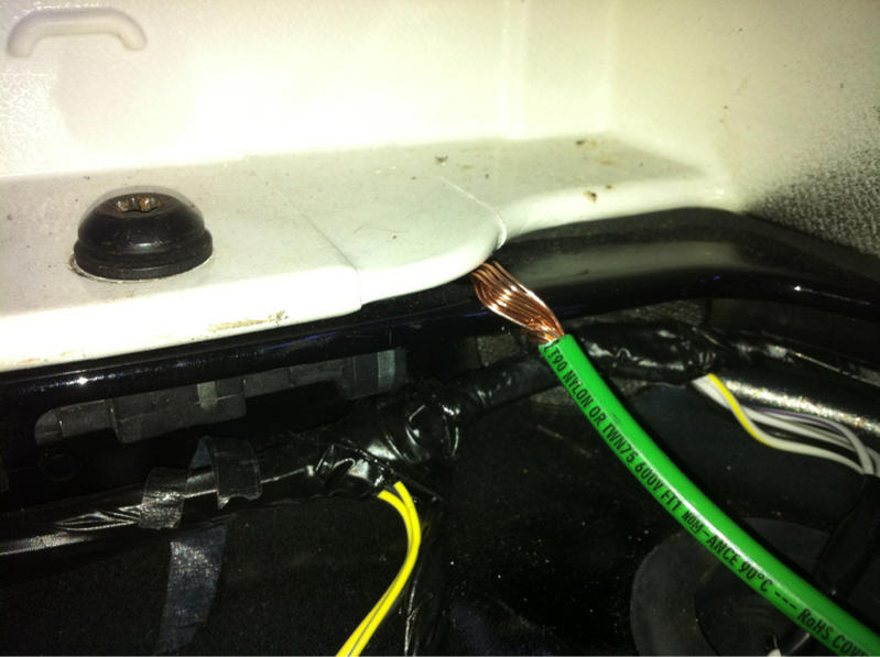

Run a ground wire from the hole in the gate to the body in the truck
That's exactly how I had the ground wire except it was mounted on the tie-down clips on the tub.

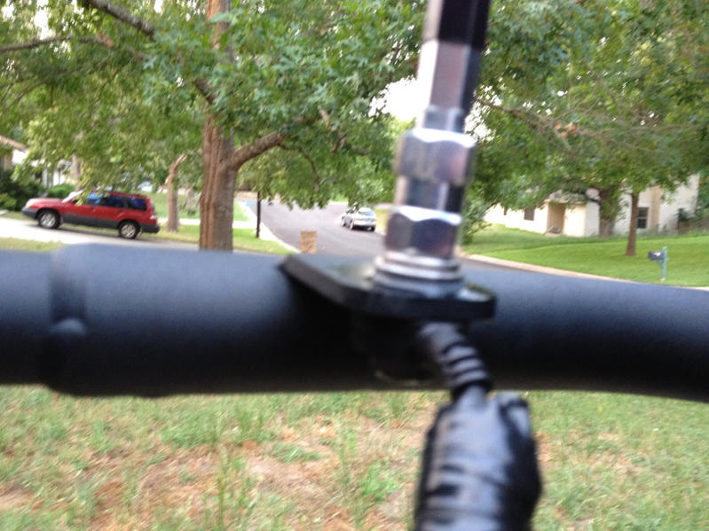

I just wanted to clear up my mounting location. The antenna is actually mounted on the or-fab tire carrier which is mounted from inside the body behind the passenger side rear tailgate. I'm really not sure if the ground is that great on the carrier but if I wanted to actually add a ground would I put it on the carrier or the actual antenna? If I was to mount it to the antenna where exactly should it be mounted? On top or bottom? Should it touch any part of the metal on the actual antenna? I'm really tryin to figure out why my swr is 10+!?!
Old May 1, 2012 | 06:33 PM
Supro's Avatar
Posts: 192
From: Austin, TX
Here's a pic.
