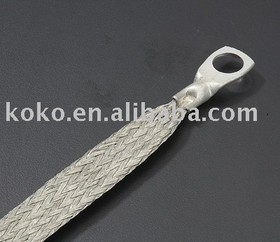

I installed the CoolTech Ultramount & still not getting good SVR readings so I want to run a ground on the antenna to insure that is not an issue but I have a couple of questions. Do I need to use a grounding strap or can I use copper wire? If cooper wire is acceptable is there a minimum or specific gage to use? Shielded or shielded?

did you sand down the area where the bolt attaches to the body?
Ground strap should be wide unshielded copper like this

I did try to sand down but the SWR reading is still high & so I wanted to insure a good ground. It sounds like the cooper grounding strap is the best bet.

I did a little sanding on the inside of the tub where the bolt mounts but I don't think it was adequate. It seemed easier to get a ground strap than keep trying to sand down inside.

Thanks for the help & I'm now set. I bought a ground strap & installed earlier. I tested the SWR & got:
Channel 01 = 1.2
Channel 19 = 1.3
Channel 40 = 1.8
I had to screw the tip down as far as I could so I'm probably going to leave it alone for now & see how it works in use before adjusting further.
